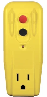

I suspect there is a way to fake out the ground fault check. I've ordered a portable GFCI outlet, as well as contacted Jackery support, to see what if anything I can do next.

Just as an update here: I've yet to make this work. The Jackery 1000 has an empty plastic slot where the grounding pin of a 120V power plug would normally go. Both the Tesla and BMW mobile charging adapters detect the lack of ground and refuse to do anything. I've tried using a portable GFCI adapter to no effect.
