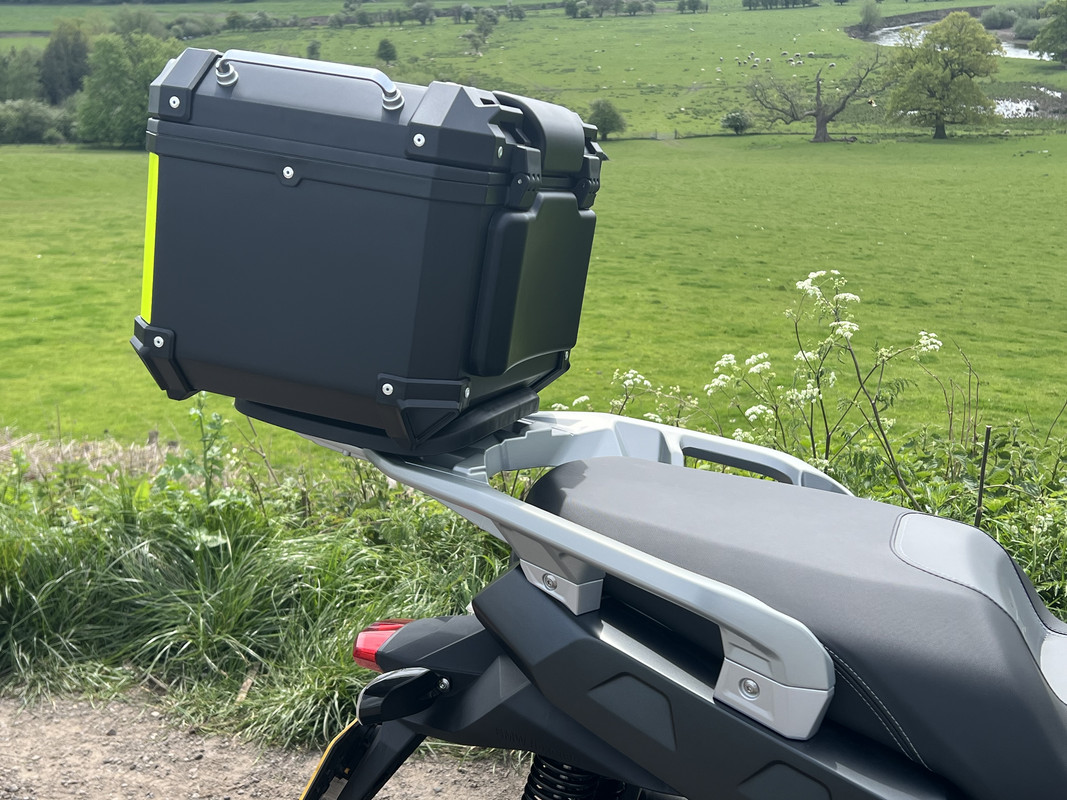

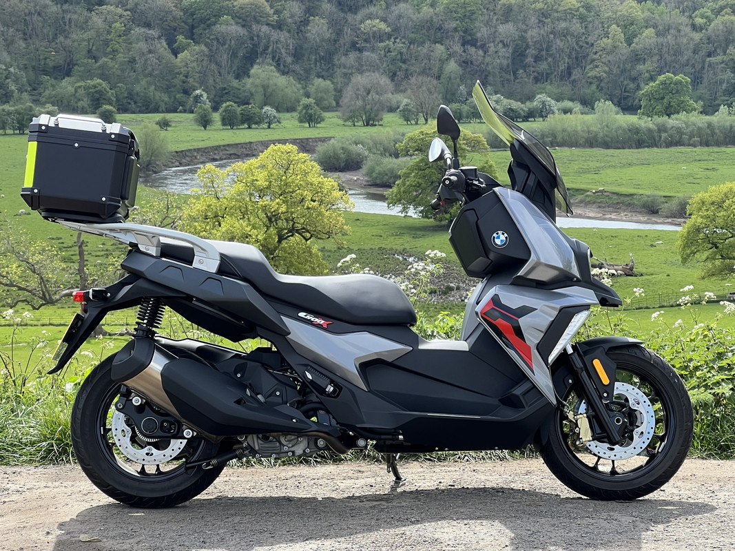

Recently purchased the BMW rack. for my recently acquired C400X. It wasn’t cheap, but as mentioned here. Very solid. Then found that to complete the installation. I needed 4 additional BMW trim pieces and special screws due to the lower part of the rack is more exposed on the C400X. This part is covered with bodywork on the C400GT.
I was not keen on the plastic BMW or SHAD plastic type top boxes, as I personally don’t like the look. Thought about a BMW Vario box. But I really wanted something that looked like the BMW Adventure type black top box.
Found something suitable. Big enough to easily take a crash helmet and other bits. I then set about fitting it.
Must admit, I took an age to work out the best way to secure the top box mount/carrier. I didn’t like the supplied fixings. Plus I didn’t want to drill or damage the BMW rack.
I replaced the two rear 6mm bolts with stainless and they lined up ok. The two front mounting bolts would not line up. So I adapted the top box mount/carrier so I could use the holes in the BMW rack. I also fitted thick rubber washers between the mount and rack, as I didn’t want to mark the BMW rack. Reason being. I change bikes like the weather. Whenever I sell a bike. Usually all the accessories come off and get sold individually.
The top box slides into place easily. Then a big bolt/thumb screw is inserted from the inside of the topbox to secure. This worried me, as if it worked loose inside the topbox. The topbox would very easily fall off the bike!
So I replaced with a longer bolt, rubber mounted penny washers and fitted a locknut. I keep an Allen key and 10mm spanner in the topbox should I need to remove it.
