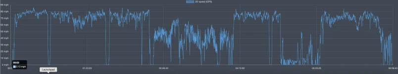

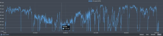

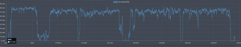

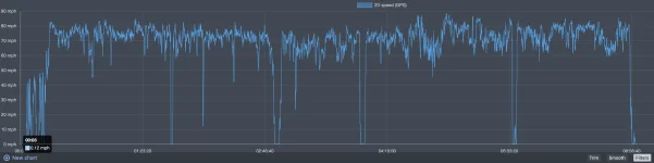

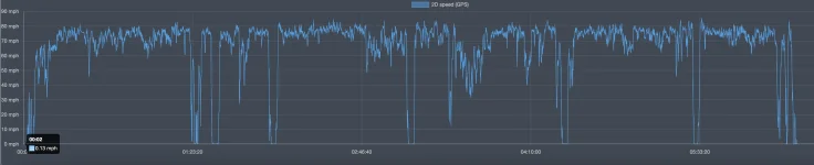

Just for reference, in case you wondering about real-world interstate traveling, here's some info for you.
As I mentioned a time or two, last May/June I rode from my home (Albany, NY, area) to Asheville, NC, to visit my daughter who lives there. I've done that trip a few times over the years, mostly solo but occasionally two-up, on: an R850R BMW; a Valkyrie Interstate; a Burgman 650; a Victory Cross Country Tour; and the C 400 GT.
All of those trips were two days each way, except for a couple of times on my first Burgman 650 (2007 - 2012), when I came home in one day. That's about an 850-mile trip, but I was much younger then.
In any case, on the C 400 GT I did the trip down and back in two days each way, almost exclusively on interstates (although on the second day down I did a back-roads detour for a couple of hours, to ride the Back of the Dragon in VA).
On the third day, starting from Asheville, I did the Tail of the Dragon and the Cherohala Skyway, and a bunch of interstates to get to that area and then return to Asheville.
And then I did some actual visiting for a few days.
That's the background. Courtesy of my GoPro 11's very good 10Hz GPS chip, here are the speed graphs of each day (until I got a flat tire on the last day, about 120 miles from home):
If you have good eyes, you can see that I did a fair amount of traveling in the 80s (along with lesser speeds, of course, and rest stops).
This was really no different from my doing this trip on those other bikes, except that the C 400 GT required more constant steering corrections, as it was blown around a bit more than all those much heavier bikes.
So, yep, if you're up to it, the C 400 can deal with interstates okay, in my opinion. Of course, this may exclude the '25 C 400, what with BMW's stated top speed drop from 86 to 80mph.
