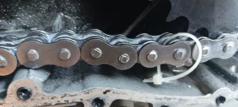

So it been 104000km very close to 60000 miles. I replaced the chain today. The chain adjusters were replaced at 25000km, 50000km and number 4 went in at 80000km.
After the chain replacement adjuster #1 left to much slack. I ended up putting #2 in. Because of this I will probably get 75000km out of this new chain

I was thinking about why the chain adjuster starts at #2. My origional sprocket was the origional style and the new one is plate steel. Every thing works as the origional and I installed it at 92000km when the bearing failed. I never thought about the diameter and could the new one be a fraction smaller.
I look at it as we just lost 25% of the life
