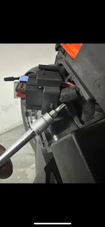

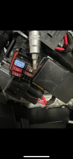

The fuses are next to the battery, on the right side of the motorcycle, use a breaker and connect it behind the fuse box.
The one I indicated with the tip of the tool is good for plugging in the seat.

That was my first option, but I discarded it because you won't be able to replace the fuse cover later. The second option was a surge protector behind the wires leading to the fuses.
