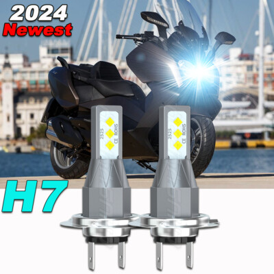

Hi, curious if you ever did the headlight conversion to LED.
Actually I did not. It is very easy to do but I believe the lamp with the LED driver is about $10usd I think. I believe you need the LED conversion kit with LED driver. If you don't use a driver the LED will most likely strobe. Amazon has them. I upgraded my last 3 BMW motorcycles but the kit was $70 from BMW. I know better now
I actually just purchased the two lamps and will install them towards the end of July. i will take a few pics of the process. When i did the upgraded on my previous K1200's and k1600 the k1600 CANBUS was too sensitive and could not detect the headlamp so it popped up a burned out headlamp warning. I had to put in a tiny resistor to draw a little more current to fool the canbus. I do not know if my scooter will do the same? I did however replace the running lights with LED on my C600 and no warnings popped up so i imagine the headlamp is the same
Update on led low/high headlight upgrade. Takes about 10-15 minutes total to replace the original. Super easy. No need to remove any screws or plastic. They work perfectly
Ok plan b. Lol. Yes my canbus system has a lamp display now. We absolutely do need to install a led resistor in line with the new h7 led lamps. Ebay has the h7 led patch wire for $10usd for a set of two. We just need to unplug the BMW headlamp plug, plug the adapter in to the plug and the other end into the LED lamp.
