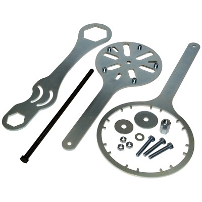

Checking the rollers and/or clutch is a little more labor intensive and best done with a BMW variator holding tool (< $50 and worth it). Photo and instructions are shown. My rollers have always been in basically the same condition as the belt. Worth noting: the clutch nut loosens CLOCKWISE. Torque for clutch and variator nuts is 100 Nm.

The video is by Easyboost, the French vendor/manufacturer of a set of tools for the variator/clutch maintenance work. I bought the set a few weeks ago and it came fast and well-packaged. It all works perfectly. I bought two belts from Caprimoto and, again, they arrived quickly from Italy (within the week) and the total cost was around 1/3 of one belt bought from the BMW Motorrad dealer.
Right you are! I did not make that connection. I bought the tools from them too - I even got a 10 % discount. I was going to buy two belts like you @Ceesie76 but then wondered if they perish over time in storage.

Delray where did you buy the tool to get the variator apart? i have been looking n no
results found. Post a link please? my brother will tackle that.
This is directly on their website.
Here's on ebay:
