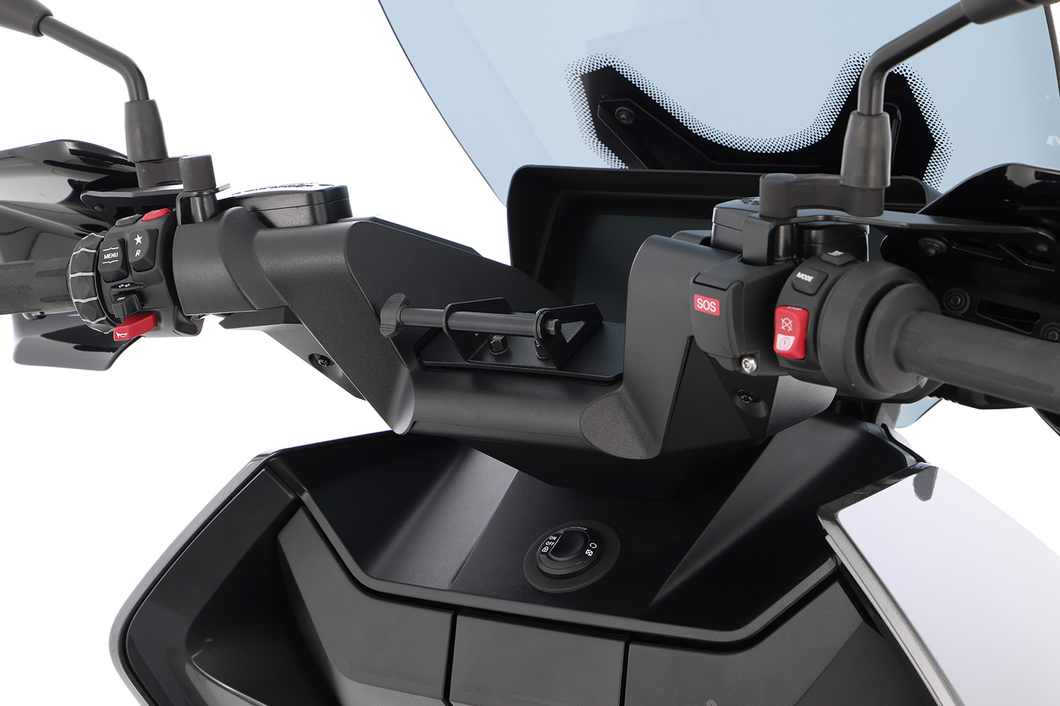

Hi. I just picked up a 23 ce04 I have been reading as much as a ossible on here but there’s not much on nav /phone mounts. Does anybody know if there is wiring for a factory gps mount? Any info on this would be greatly appreciated
Kevin
Update:
So I saw on another post there is a connecter under the plastic bar cover
It is infact a bmw gps plug. I mounted a factory nav holder and plugged right in
Powers up and down fine but this particular mount doesn’t do modbus comunication
I am wondering if a newer gs mount would
I am using a chigee bmw aio5 for carplay
And can easily swap to nav 6. Also it’s easy to transfer between my. GSA and my scootIMG_0730.webp
