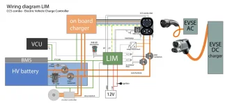

My CE 04 stopped being able to be charged. BMW replaced the LIM (charging module) it seems to have fixed the miss reporting issue.
LIM diagram from i3
