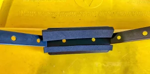

I think Cymarc should have included a clearer picture or two depicting the placement of the bottom (i.e., front-side) foam pieces. That is, I think they should have included a photo like this, which I took
I was a little annoyed that I had to cut the sticky-backed foam lengthwise into two 5mm strips. This is pretty narrow, and I enlisted my wife, who supplied some very small and very sharp sewing scissors for this task; working with such fine tolerances took nerves of steel during the cutting. Given the cost of this product (see earlier post), I feel that the foam should've been pre-cut.
I also feel that when ordering the system in black that the security bolts should have been anodized in black, too, but I suppose that that's a matter of personal preference.
I was a little concerned that the front side of the strap might be too close to the bodywork over the headlights, and so might scratch it, but that turned out to be a non-issue. The two foam pieces that go underneath that area keep it sufficiently raised off the plastic.
