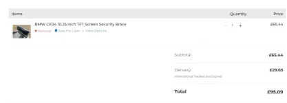

I can tell exactly what this runs to, in USA money, because I ordered one -- with the security bolts and wrench -- on May 10.
Screen grab of order page:
Screen grab of PayPal receipt:
And it looks like the exchange rate is about the same now as it was a week and a half ago, or perhaps a tiny bit worse, if I'm reading this chart correctly:
So, yeah, this is very expensive ... but then, so is the TFT. I, too, don't think this is a problem in the USA (yet), but I don't want to be the first one to find out if and when it does become a problem.

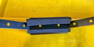

I think Cymarc should have included a clearer picture or two depicting the placement of the bottom (i.e., front-side) foam pieces. That is, I think they should have included a photo like this, which I took:
I was a little annoyed that I had to cut the sticky-backed foam lengthwise into two 5mm strips. This is pretty narrow, and I enlisted my wife, who supplied some very small and very sharp sewing scissors for this task; working with such fine tolerances took nerves of steel during the cutting. Given the cost of this product (see earlier post), I feel that the foam should've been pre-cut.
