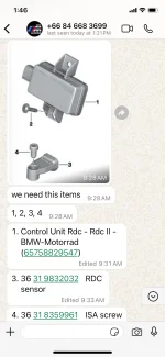

2) WhatsApp With Phad:
I did some communicating with Phad this summer, via WhatsApp. His number is in the description text of some of his videos, and you'll see it in a second.
(By the way, this is the only social media account I have -- no Facebook, no X, no TikTok, etc. The only reason I installed WhatsApp is because on Edelweiss tours lately, that's how the guide(s) and customers communicate if necessary, swap daily pics, etc.)
Okay, here's my "conversation" with Phad:
Conclusion?:
So, what it seems to me is that:
- You need to get those internal BMW (or equivalent) TPMS sensors, and put them in the wheels next tire change. It's not at all clear to me how they are attached inside the rims, but my guess is that it's the same way that other Beemers do this (since they are Beemer sensors). Probably not a really big deal (other than the expense of the sensors).
- You need to get an electronic receiver box, mount it somewhere on the bike (and he shows in one of those videos that he put it under the front right-side tupperware), and do some appropriate wiring, so it gets power.
- Have some programming done, so the bike: A) recognizes the receiver, and; B) adds (or unlocks, or something) the TPMS display screen in the TFT's collection of screens. I believe that such programming is something that Phad can do remotely, given the proper computer setup attached to your bike. Or something along those lines.

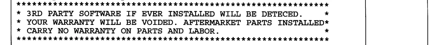

On top of all that, Max BMW -- which has four stores in three states, and one of which is where I bought the bike and have it serviced (although I used a second location for emergency tire replacement) -- appends this to all its invoices:
I don't know whether this is unique to Max, or SOP for other Beemer dealerships. And as some folks -- @mzflorida comes to mind -- have pointed out in other threads, it would be incumbent on Max or BMW to demonstrate that adding a TPMS display to the bike's firmware was the cause of, say, an engine failure's warranty claim. Nevertheless, those sorts of warnings frighten me (and recall that I've already had one C 400 GT replaced).

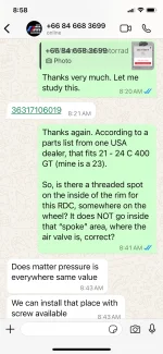

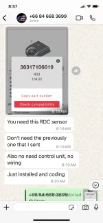

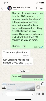

I decided to follow-up once more with Phad, yesterday and today (given the extreme time difference, of course, between Thailand and NY). I wanted to see if I could get clarification from him, regarding how and where BMW's RDC (TPMS internal sensor, in more common terms) gets attached. Here are the relevant WhatsApp screen grabs:
The upshot of this recent exchange with Phad is, I think:
1) It looks as if Phad thought I had an older C 400 GT (and I'll get to that in a second). Given that I have a '23, he revised the RDC part number, and cut out the need for the receiver. So it also looks as if he had been working on one of those older models in his videos (e.g., in one of which he points to where he added the reciever).
2) I still didn't get a straight answer, regarding where the RDC is mounted. I guess this is a communication problem between our languages. I get the impression or guess that there is some threaded area inside the circular part of the rim that accepts the screw that holds the RDC in place.
3) I also get the impression or guess that the newer models are prepped to communicate with RDCs (hence, no reciever).
