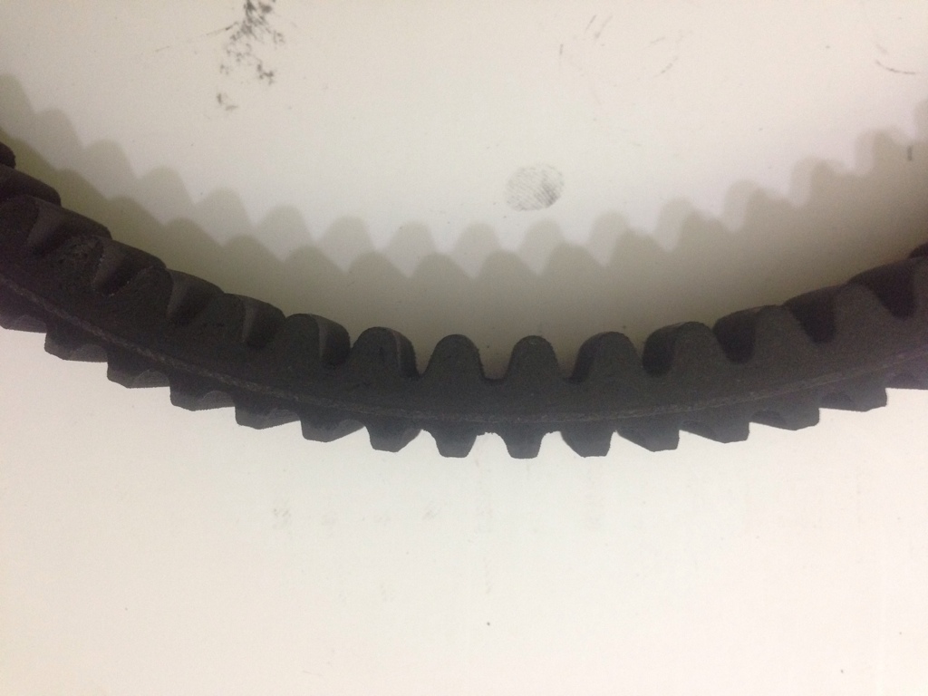

20k service on Tuesday.
The belt looks in good shape and the rollers aren't in to bad of shape a lot of times up you can clean out the dust and crud at the rollers and the shoe and the bike will run a lot better the only thing is if you are going through that trouble you mite as we'll change them. The big deal is getting all the plastic on the bike off. The Gilera 500 I own I can get at the rollers and belt and use compressed air and blow out all the crud and the bike runs much smoother for quite awhile, also I don't have to deal with as much plastic as the 650 gt has.
That's what i thought too. I think i'll try extending e belt replacement interval to maybe 25,000-30,000km and see how it goes.e labour charges is really high here and e same in other parts of e world as well... I hope e pics come in helpful for most of us. I would also love to see e receipts from e others who have done e 12,000miles/20,000km service and maybe some pics of e components...

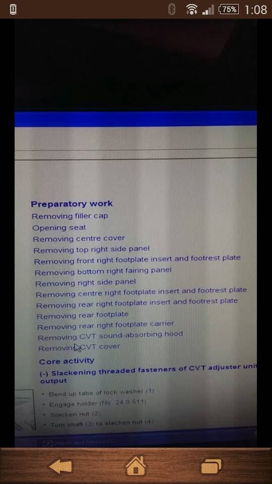

The long list to remove the belt

Belts are made of many materials and chemicals, and every manufacturer has their proprietary blends. You can't tell from a picture.
