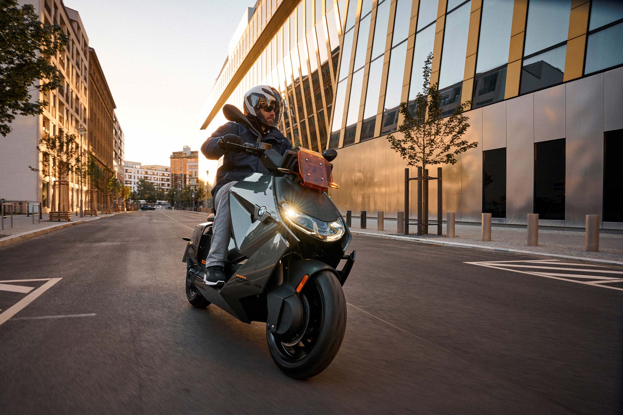

It really seems like we have a different headlight, possibly totally without that adaptive headlight. Even though it's in my build sheet.
The EU version has a symmetric light, low beam on the bottom and high beam on top. The US version has the low beam on the right, and high beam on the left.
Apparently it should activate at a speed of >6mph and a lean angle of >10 degrees, which is easily achievable.
