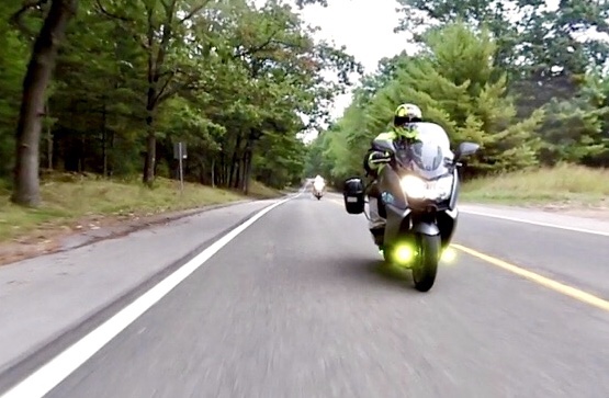

Like TwoPort I have the Clearwater Darla lights, expensive but very high quality, very bright and superb customer service. You could move these to a new bike and will last for years. The power for these is wired directly into the battery and then a relay is used to power on only when bike is running. This is a tap into the fuel pump power (I think an article on WebBikeWorld explained how he used this for another brand of lights). The relay switches on the lights only when the bike is running. There is also a dimmer switch and an option to go full bright when high beams are on by accessing high beam power wire. With yellow light cover on makes you very visible during the day and with clear or no covers can be very bright at night.

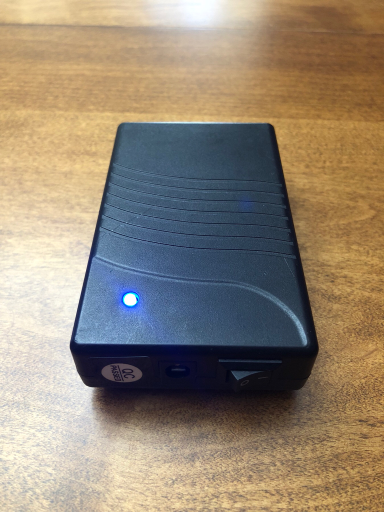

If you are talking about more of side or accent lights, an option to avoid messing with bike power is to go to auto store or Wal-Mart and get some auto LED strip lights and mount these where you would like. You can run the power cord to under the seat and use a 12v battery pack to power these, especially if only wanting for night use. With my previous Honda I decided not to add onto electrical system and I ran 2 sets of LED strips on the rear top box in red and drilled a small hole and ran power cable inside and in the box I had a small 12v battery pack that I could switch on at night. This would add a nice always on red light to top box which was up high to make me more visible at night besides tail lamp plus could be seen from the sides. This battery pack would easily power these lights for 6-8 hours as they were LED and don’t use much power. You can buy these 12v battery packs on Amazon in various sizes.

I second the Clearwater Darla’s! Running with the yellow filters during the day are a great safety feature to be that much more visible! Riding at night the extra illumination, especially peripheral, is outstanding.
