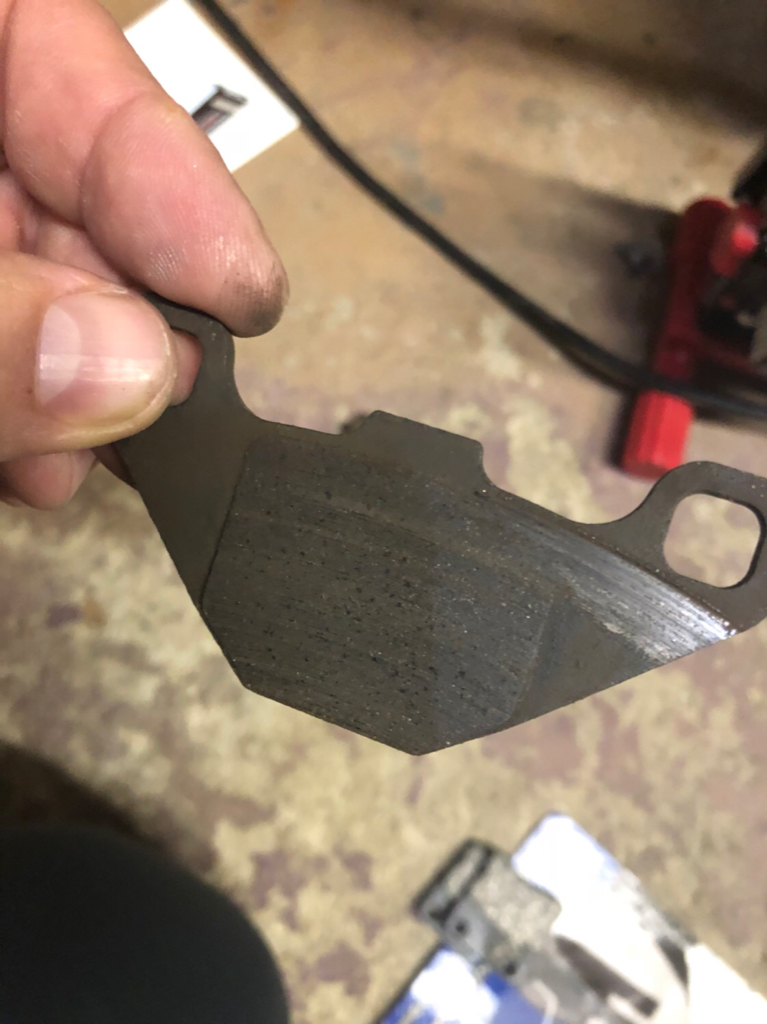

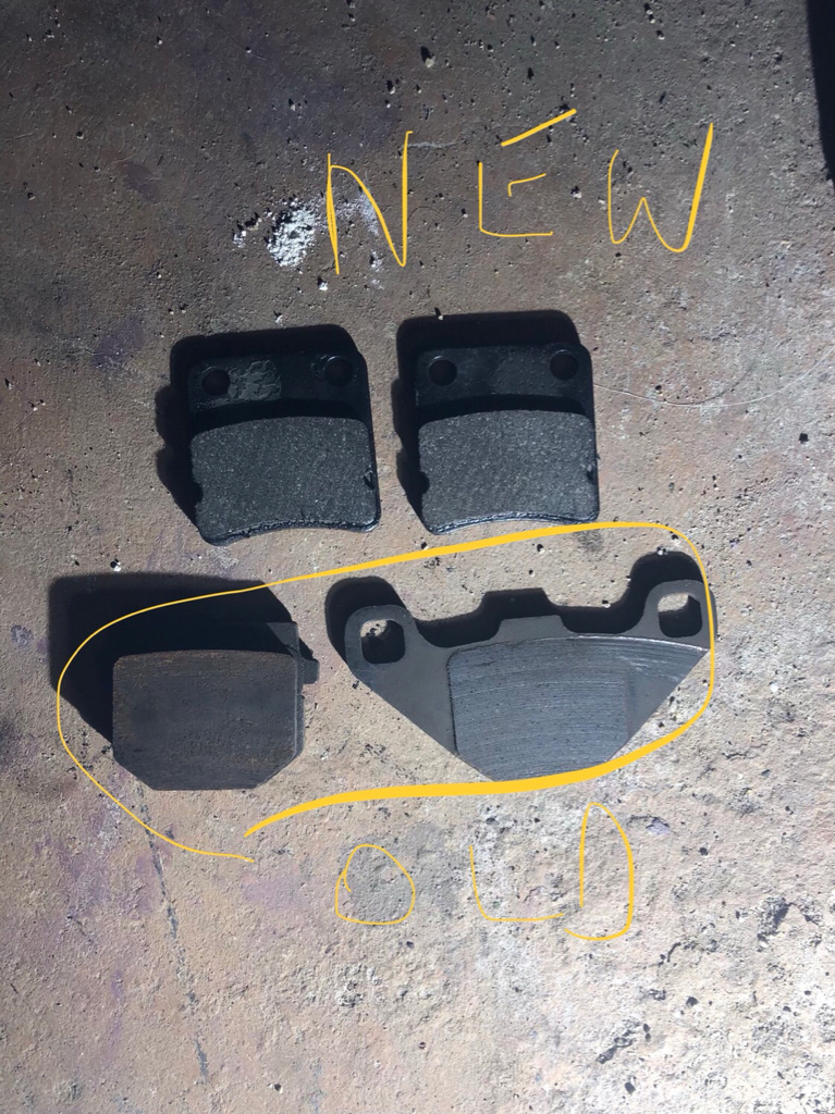

Changing out parking brake pads as non functioning and looked like inner pad was worn. Replacement pads look nothing like OEM, online catalogs all show similar small pads and looks like there was a break in part numbers in 2014 but all images show smaller pads. Any ideas?

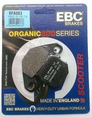

I have a 2014 C650GT USA model. About 14K miles. I purchased EBC SFA257/2 brake pads which most sources indicate will fit. From my research so far it looks like EBC SFA083 are the pads that are being used in mine. So far these seem to be available from UK and Germany only.

I also look at the parts fische at MAX BMW and it definitely looks odd. The part number is:
34 21 8 526 263 SET: SET OF BRAKE PADS, PARKING BRAKE (to 01/14)
but the picture looks like the new (incorrect) set you received.

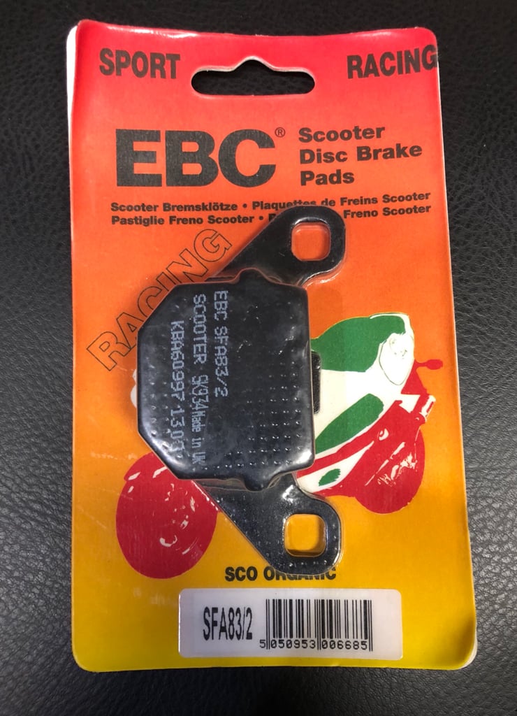

Well I ordered from both BMW and an eBay seller from Germany selling EBC pads and the EBC pads arrived yesterday. Installed tonight and they were the correct fit. SFA83/2 Cleaned everything up and removed entire caliper and checked function, all seemed good, reinstalled and adjusted per service manual. Hopefully these don’t wear out like OEM set, more wear on inner parking brake pad than any other pad is not right.
Dragging pads are usually caused by one of two causes. Overly snug adjustment or a stuck caliper. Calipers have to be free to move a bit to equalize pressure on the pads, once released they must be free to move side to side a bit. That one in your photo looks like it was held against the disk when the kick stand was retracted. How does it feel when you hold the pads on and move the kick stand. It's also possible something like a small stone got under that worn pad and kept it against the disk.

I had noticed sometime early in the year the parking brake was not holding but never took the time to re-adjust. I have adjusted it several times in a manner similar to you. When I put new pads on the rear and inspected the parking brake pads I saw the irregular wear. When I replaced the pads I removed the caliper, cleaned it off with brake clean and checked for smooth operation and all seems well. Reassembled and adjusted to moves freely with stand up and grabs lightly with stand down. No sure what happened but I'm going to keep an eye on the adjustment and wear.

thanks for the image. i have received the wrong pads for my caliper from we moto today but will now be able to quote the correct part number.
